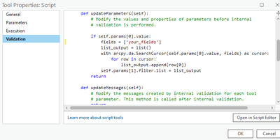

This is my dummy script
In the parameters, I have this configuration
Then in the validation, I insert this script. The key is in the conditional of params[0] and has a value. Then, by using arcpy.da.SearchCursor to iterate a column that we desired.  Don't forget to put the iteration value to an empty list that has been defined before.
Last is running the script. The filtered_value will show the value from the parameter feature layer that has been selected in my case.
Hope it helps you,

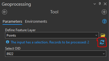

My dropdown list is populating correctly. The issue is that if the selection changes while the tool is open, clicking the refresh arrows does not call updateParameters() and does not update the dropdown.  Below is a screenshot, and an example .pyt script.
