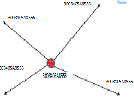

Helllo,
Line Features is touching the point Feature, So I need to update the PointID to the Line feature attribute table.

Hello,
I have Point Feature class, In these Point Feature is "GIS_ID" field, SO I need to update the "GIS_ID" values which Line Feature class touch the point feature using Python Script automatically.

Hello,
