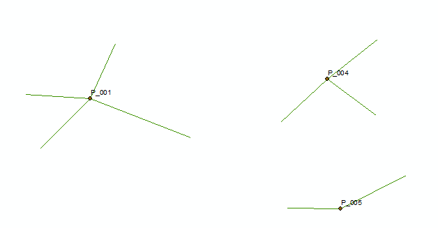

Hello,
I have point Feature to the following attribute values.
OBJECTID *Shape *Point_IDPoint_Name
1PointP_001TVR
2PointP_002MS
3PointP_003CSS
4PointP_004GGG
5PointP_005FAN
6PointP_006NAP
7PointP_007TNEB
8PointP_008EB
9PointP_009GO
10PointP_010GD
and I have Feature to the following attribute values.
OBJECTID *Shape *Line_IDLine_NameL_Point_IDSHAPE_Length
1PolylineL_001HTP_0011.311433
2PolylineL-002LTP_0011.404263
3PolylineL_003LTP_0011.422833
4PolylineL-004HTP_00424.26874
5PolylineL_005LTP_00435.43787
6PolylineL-006LTP_00413.04293
7PolylineL_007HTP_00544.00131
8PolylineL-008LTP_00529.63592
I tried to update Point_ID Updation in Line Feature using arcpy.SpatialJoin_analysis but The output come both table values. I need only targetFeatures (Line Feature all values)  + Join Feature(Point Feature Point ID only). I tried to the following code:
import arcpy
import os
workspace = r"D\Input.mdb"
outWorkspace = r"D:\Output.mdb"
targetFeatures = os.path.join(workspace, "Line_Feature")
joinFeatures = os.path.join(workspace, "Point_Feature")
outfc = os.path.join(outWorkspace, "Output_Feature")
fieldmappings = arcpy.FieldMappings()
fieldmappings.addTable(targetFeatures)
fieldmappings.addTable(joinFeatures)
GISIDFieldIndex = fieldmappings.findFieldMapIndex("Point_ID")
fieldmap = fieldmappings.getFieldMap(GISIDFieldIndex)
field = fieldmap.outputField
field.name = "L_Point_ID"
field.aliasName = "L_Point_ID"
fieldmap.outputField = field
fieldmap.mergeRule = "Mode"
fieldmappings.replaceFieldMap(GISIDFieldIndex, fieldmap)
arcpy.SpatialJoin_analysis(targetFeatures, joinFeatures, outfc, "#", "#", fieldmappings)
Regards,
Raj P
