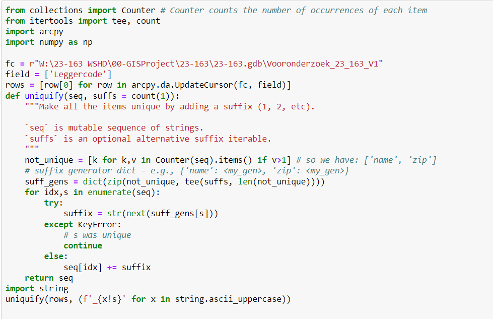

Dear all,
I have renamed field values with my code which is shown in the figure below. The values are stored but if I reopen my attribute table, the same old values appear. It seems that the attribute table is only updated when I restart my project in ArcGIS. This is rather inefficient so I am trying to find either a function in ArcPY that updates my rows or whether there is a refresh table button.
It seemed there was a Reload cache button but I cannot seem to find it.
I am looking forward to your replies.
Kind regards,
Marc
