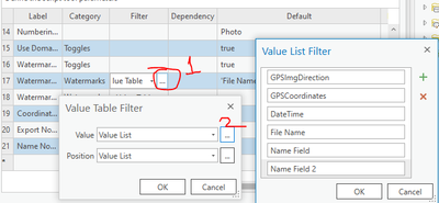

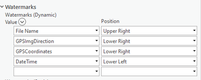

Value tables are kind of a pain, but they can definitely simplify your input a lot.
I wanted to give you a tool validation example on filtering, but it's giving me issues today.
It's hard to say without seeing your tool, but I think they're worth investigating
