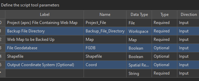

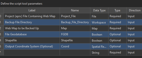

When I run it in ArcGIS Pro as a script tool, it runs no problem.  Here are my tool parameters:
What is the difference between the script succeeding in creating an out path name when running in Pro, versus running as a scheduled tool?  I've tried choosing the output location in different places, including on the C drive, and making sure there are no hyphens in the path, but that doesn't seem to make a difference.
