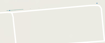

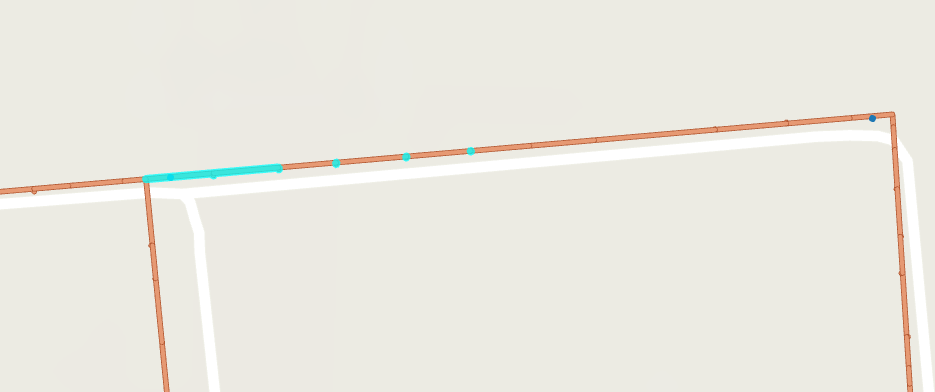

  • Input method
  • Result
  • All the attribute data between "Start point" and "end point" is visible in Output but when I try to draw that on the map, it draw only which is shows in selected above

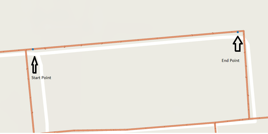

The logical approach taken for this in script:
  1. Draw two points on the map.
  2. Create a line geometry connecting the two points.
  3. Buffer the line geometry to create a search area.
  4. Select all polyline features that intersect with the buffer zone.
  5. Export the selected features to the output feature class.

Hi @ArchitGIS
Your code worked fine for me when selecting all lines between two points. There was an issue if the Map was in a different projection that the layer itself.
~ learn.finaldraftmapping.com
