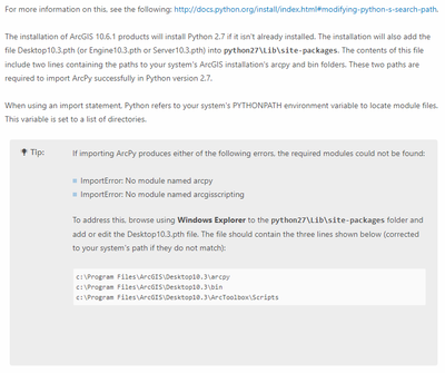

humm interesting. Can You open the py file using the IDLE try to run it see if you are getting any error messages. (right click on the file and select Edit with IDLE). I use this all the time and it works on desktop and servers
JamesStout101
Error
File "C:\Users\jstout\Desktop\PY\MorningProcess\MorningProcess.py", line 1, in <module>
import arcpy, arceditor, time, smtplib
ModuleNotFoundError: No module named 'arcpy'
DominicRobergeIADOT
look at this link in the Paths and import section
https://desktop.arcgis.com/en/arcmap/10.6/analyze/python/importing-arcpy.htm
