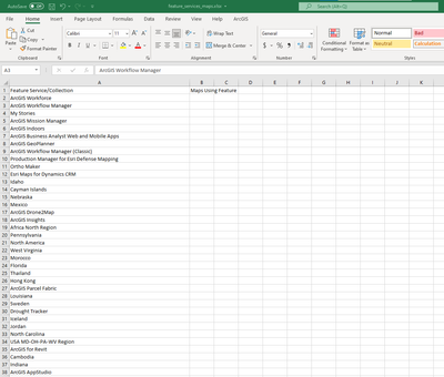

So I am trying to create an excel document that list all of my feature services / feature collections  and what specific maps they are in, so far I have this, but when it runs it lists all my services in Column A, but then Column B is blank, any idea what could be happening?  I am very new to python.  Any help would be appreciated.

This is what the output looks like for me, I am using Enterprise 10.8.1, it seems like it is picking up more than just services but the built in esri tools as well.

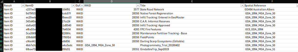

I then also played with the coding posted here (Solved: Re: Where's the spatial reference information? - Esri Community) to print a list of feature services in ArcGIS Online and their WKID's which I could copy/paste into excel and also perform a Vlookup to the item report from ArcGIS Online to get more info for each layer.
from arcgis.gis import GIS
# Connect to AGOL
agol = GIS("home")
# Search for all items in AGOL
items = agol.content.search(query="", max_items=10000)
# Iterate through each item
for item in items:
    try:
        # If it is a feature service or vector tile package
        if item.type in ("Feature Service", "Vector Tile Package"):
            # Print the WKID of the SRS
            print("Item ID: {0}, WKID: {1}".format(item.id, item["spatialReference"]))
        else:
            print("Skipping Item ID: {0}, Type: {1}".format(item.id, item.type))
    except Exception as e:
        print("Failed to process item ID: {0}, Error: {1}".format(item.id, str(e)))
