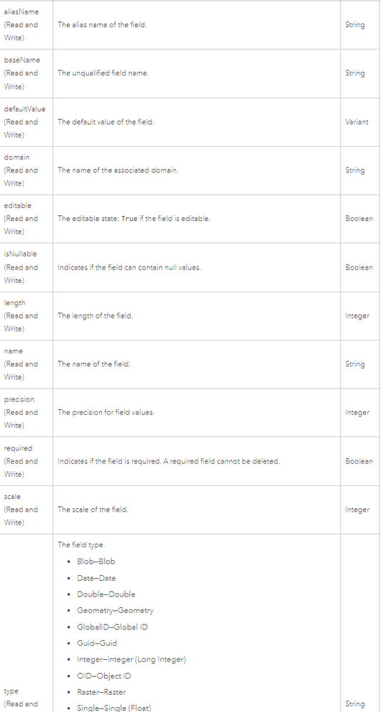

Well, let's look at Field's properties:
That's a lot of properties you'd have to set. Granted, you probably only really need name and type, but maybe some other properties are important for your use case. And the FieldMap object automatically sets these properties to appropriate values.
So the easier way is to get this automatically created Field object, change one of it's properties (name) and give it back to the FieldMap.

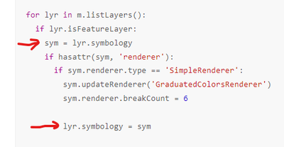

ESRI uses this pattern in other places too.  For instance in arcpy.mp:
It took me a while to get somewhat comfortable with it.  My current mental model is: get object (think of as template) > modify properties > set object, which gets me over the hump.
This pattern does feel idiosyncratic, and I've never truly understood if the API could or couldn't be improved to set these properties directly.
