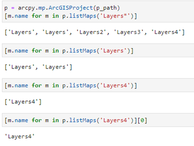

@AlfredBaldenweck is correct.  The parameter you are passing into listMaps is what ESRI calls the wildcard, although it behaves more like a regex match, seeking that exact name, except if you pass the star wildcard (see image below).  You are correct, if the wildcard is left empty, you should get a full list of all your maps.  If you are not getting a list of your maps, then something is wrong with your code (wrong path?).  Here are a few examples of how one could use the wildcard.  Notice, list maps returns maps objects, if you want names, you need to reach into the name property.  I created a list of names below using a list comprehension on the name property.  Also, notice, as @AlfredBaldenweck mentioned, the index ([0]) is just for accessing single maps (or slicing [1:3] multiple).
A word of caution...ArcGIS Pro allows same name maps as seen above.  The user will have to use manual conventions to avoid this ambiguity if trying to access maps from listMaps().
