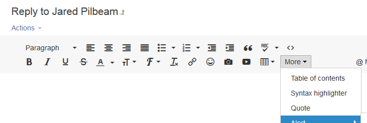

RebeccaStrauch__GISP
MVP Emeritus
Make sure you open the post in a new tab when you reply.  If you are looking at it in the geonet inbox you will not see the option.
JaredPilbeam1
Deactivated User
Thanks Rebecca. Here it is.
