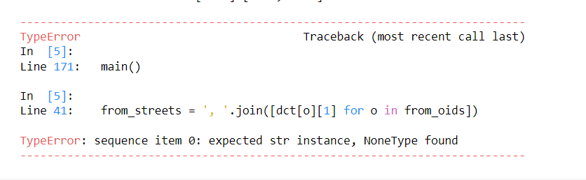

ahagopian_coj
I know this post is a bit old but I am trying to use your python script to do the same thing - calculate to and from streets per street block/segment.  I keep getting an error and can't figure it out.  PYTHON ERROR.PNG
