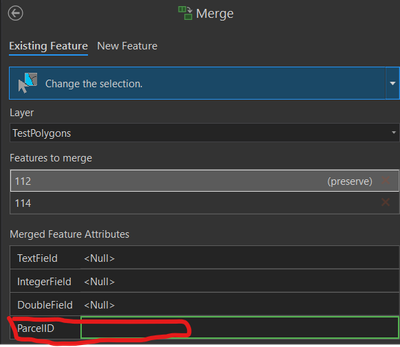

You could just add this Attribute Rule:
// Attribute Rule
// field: ParcelID
// triggers: Update
var id = $feature.ParcelID
if(id == null) {
    var new_id = NextSequenceValue("SequenceParcelID")
    return new_id
return id
And then delete the ParcelID in the Merge dialog:
Have a great day!
