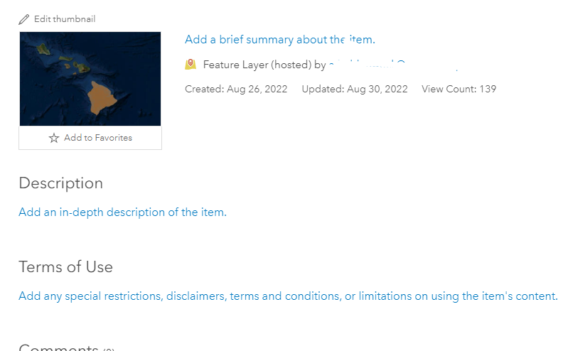

It works fine when  mapL is set to "Map" (Line 4), but when I added those same layers to a a new map (and saved) , then replace "Map" with the new name, it will run all the way through with no problems, but the updated web layer won't have anything in it
The only change I'm making to the code is the value in mapL. I'm not getting any index errors, so I 'm sure that everything else is right. Does anyone have any ideas as to how to fix this?
