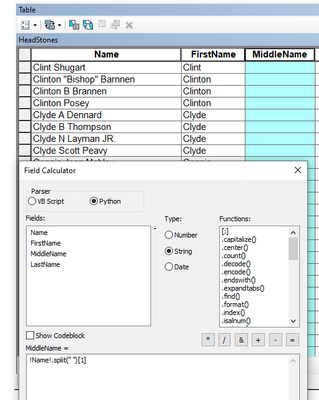

I have a filed containing first, middle, and last name Ex:Emily Smith Brannen.
I want each name in a different field. In other word: the siring before the first space in one filed, the string between first and second space in another field, and the string before the last space in a third field.
39032725-49e9-4453-b860-5414d971f3df.png39032725-49e9-4453-b860-5414d971f3df.png image.pngimage.png
The script works If I do the calculation on one record but not on the whole filed.
Any help would be appreciated.

strip any potential leading trailing spaces.  See the example output below... the last print line is correct,
for n in name:
    print(n.split(" "))
    print(n.split(" ")[1])
    print(n.strip().split(" ")[1])
['a', 'b', 'c']
b
b
['d', 'e', '']
e
e
['', 'f', 'g', 'h', '']
f
g

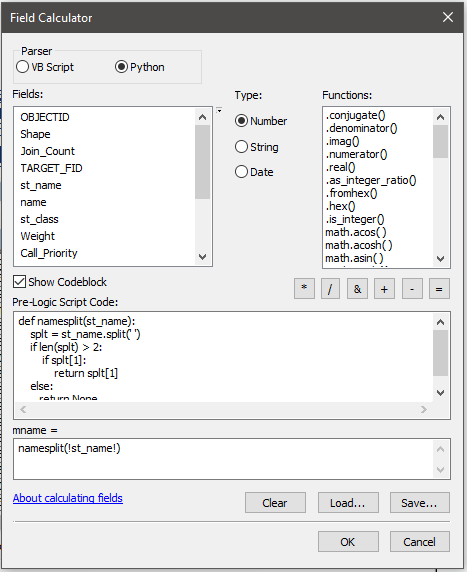

That could be a lot things causing that error.  Since it looks like the names do not contain all three (first, middle, last), you need to account for those like Clint. You can do that with using a function.  Make sure python is checked, and Show Codeblock is checked. If there are only two, like Clint, youll need to skip the middle name because Shugart is probably their last name.  Indenting counts here, and can be a pain so make sure you use 4 spaces per indent if the code doesn't copy paste correctly.
def namesplit(name):
    splt = name.split(' ')
    if splt[0]:
        return splt[0]
    else:
        return None
# and in the FirstName block:
namesplit(!Name!)
def namesplit(st_name):
    splt = st_name.split(' ')
    if len(splt) > 2:
        if splt[1]:
            return splt[1]
    else:
       return None
and last name code:
    if len(splt) == 2:
        if splt[1]:
            return splt[1]
    elif  len(splt) > 2:
        if splt[2]:
            return splt[2:]
    else:
        return None
added return splt[2:] to capture the Sr, Jr, etc.

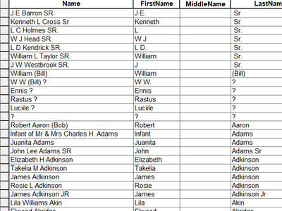

MariyanaKostov1
I was able to get the first and last string. Not sure how to get the middle
