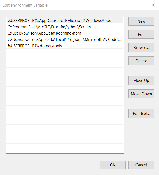

Brian_Wilson
Honored Contributor
I just put the conda.exe I use on my PATH environment variable so that it's always available to me in every shell or IDE. It's the second line here.
