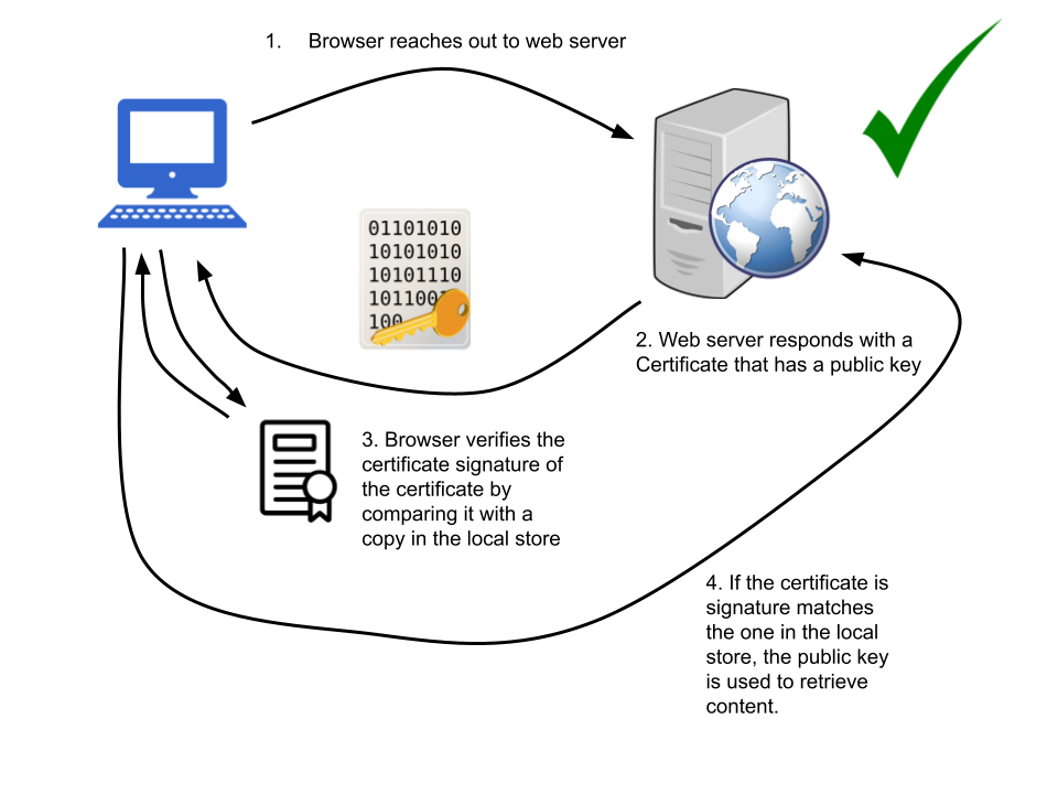

How I thought certificate checking works
I originally thought that a certificate just needed validated against some authority and then it would allow traffic to flow.
Not How Certificates Are VerifiedNot How Certificates Are Verified
How Certificates Actually Work (ish)
My previous understanding caused me to feel stuck because I was experiencing SSL errors trying to download data using python requests and getting failures even though I was able to download the same data using a web browser or other client software. So why was Python the only environment indicating an invalid certificate? Because this is roughly how the verification process actually works.
 The crucial detail I was missing was that my own computer had a previously downloaded copy of the certificate and when Python was checking the one received from the remote server against the local, my local copy still showed it was expired.
