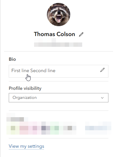

and every single possible variation of python new line and all I get is

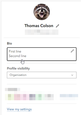

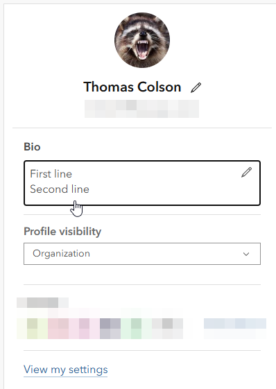

What I need is:
Declaring a string doesn't work either. No matter what, it puts all the text on a single line in the profile.

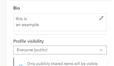

user.update(description='this is
an example')
returns the following:

Hi @ThomasColson1, I used Fiddler to see what was being sent when updating a profile's description.  I found &#13; was used for a carriage return.  According to this link, this is the HTML Number.
user.update(description='this is &#13;an example')
