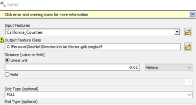

Step-1: Create a negative buffer

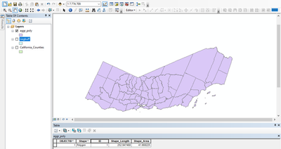

Use Dissolve on the buffered polygon FC.

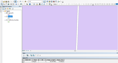

On a smaller scale, the dissolved/ buffered polygon looks fine.
But when zoomed into the boundary (1:10 here), you can see the gaps.
