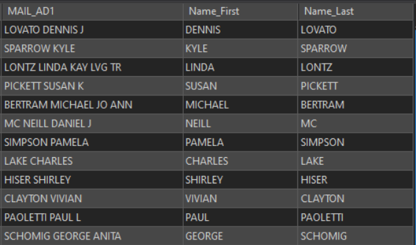

I'm trying to slice with an index to get everything that comes after the first value in the MAIL_AD1 field and use the update cursor to put it in the Name_First field. As of now I can only get the second value and nothing more.
Here's the table I'm working with:
This puts the correct value in the Name_Last field:

But when I try to slice with an index number I get the error, which happens on the row[1] = s[1:] line.
def Name_First(): #this function updates the Name_First field
    with arcpy.da.UpdateCursor(fc, field) as cursor:
        for row in cursor:
            unit = row[0] #get Unit in field list
            if unit is None:  continue  # continue to the next iteration in loop if None
            s = str(unit).split() #split strings in MAIL_AD1 field
            row[1] = s[1:] #update Name_First field with what comes after first value in MAIL_AD1 field
            cursor.updateRow(row)
    del cursor
TypeError: value #1 - unsupported type: list

If I run
row[1] = s[1:][0]
print(row[1])
it's only returning one value.
DENNIS
KYLE
LINDA
SUSAN
MICHAEL
NEILL
PAMELA
 This is what I'm expecting:
DENNIS J
KYLE
LINDA KAY LVG TR
SUSAN K
MICHAEL JO ANN
NEILL DANIEL J
PAMELA
If I do this it's back in a list again.
row[1] = s[1:][0:]
print(row[1])
Prints:
['DENNIS', 'J']
['KYLE']
['LINDA', 'KAY', 'LVG', 'TR']
['SUSAN', 'K']
['MICHAEL', 'JO', 'ANN']
['NEILL', 'DANIEL', 'J']
['PAMELA']
