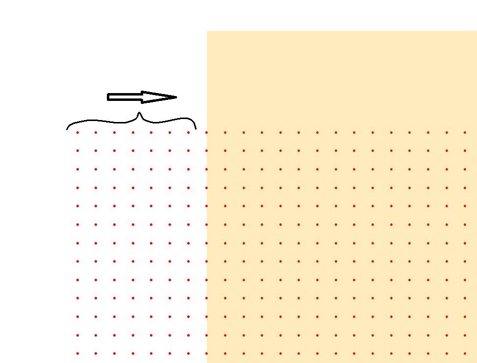

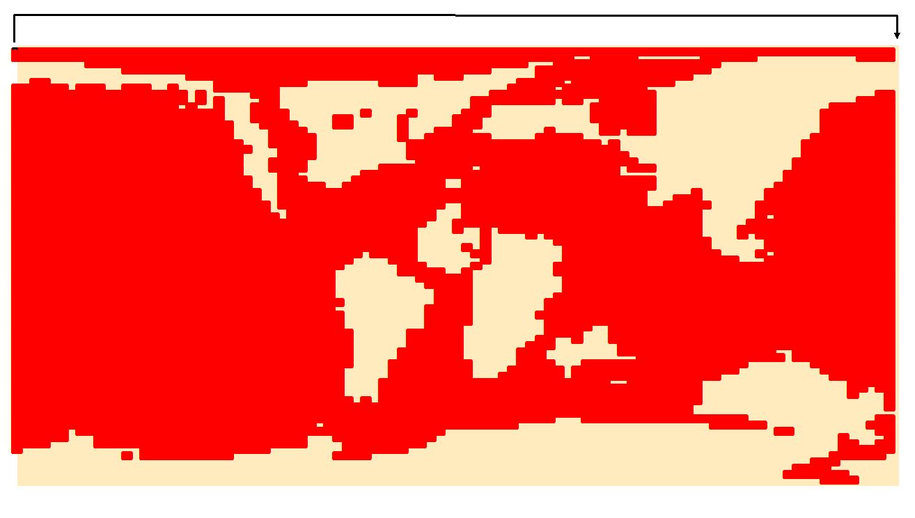

Hi,
I need to shift by 360° points that are offset. It is just 7 columns of points in the West on the X axis that need to be shifted (see pictures  and script below).  I'm getting this error: TypeError: 'float' object has no attribute '__getitem__'
Also, I'm not sure if I'm selecting/identifying the 7 columns of points I want correctly on my script.
Any help will be much appreciated.

Are you selecting first only the points you want to shift?  If you have a feature class with lots of points and only want to shift some, you either have to understand how the points are ordered or only select those you want to shift; otherwise, you won't have any way to know whether a point needs to be shifted or not.
In your code above, row will be a list with a single X value, the X value of the "first" point, whatever that point is depending on the ordering of the cursor.  Your code is failing because row[0] returned a float, and floats don't support indexing, slicing, or other similar functions that sequences support.

Your points look like a raster that has been converted to points.
Do you want to shift a raster?  This can be done using the Shift tool in Desktop and Pro.
