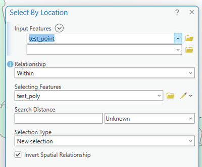

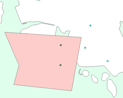

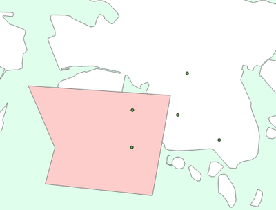

For which I also have created a new database with a point (5 features) and polygon (1 features) layer:

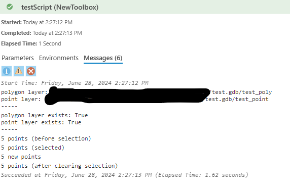

I have also created a new tool to test this with, for which I am getting the output (with some small print statements added):
Which suggests that no selection is being done. Using the Select By Location tool within ArcGIS Pro (the same equivalent?) the selection works:

You are running your python on feature class inputs, not feature layers (which is what you're running the tool in Pro on). A feature layer is a temporary construct within a Pro session which gives you a view, symbology etc of your feature class.
Use the Make Feature Layer tool first in your script, then use the two layers you create as your inputs for the select by location and I suspect you will have more success.
Or (as I can see you've attached it to a toolbox) make the inputs for the tool "feature layers" allowing you to drag and drop from your table of contents

That's a good point. I'd also try assigning the selection to a variable to pass into copy(). See Lines 11 and 14.

Good suggestion, I will implement this as well!
blob
This worked, thank you!
