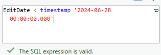

Hey All,
I'm attempting to query a feature layer using the ArcGIS API for Python, and when using the where clause for a timestamp, I'm getting met with errors, even though it's validating within Select By Attributes in Pro.
where = 'EditDate < timestamp \'2024-06-28 00:00:00.000\''
I have attempted everything in this link, but none have worked, very confused on where I am going wrong here: https://community.esri.com/t5/arcgis-api-for-python-questions/querying-a-date-field-on-a-feature-lay...
Thanks in advance!

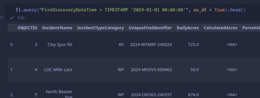

jcarlson
MVP Alum
Here's a living atlas layer:
https://services9.arcgis.com/RHVPKKiFTONKtxq3/ArcGIS/rest/services/USA_Wildfires_v1/FeatureServer/0/query?where=FireDiscoveryDateTime+>+TIMESTAMP+'2024-01-01+00%3A00%3A00'
Is it as simple as putting TIMESTAMP in all caps? I haven't known it to be case-sensitive in the past, but if yours isn't working, I'm at a loss. It's a DateTime field, not a Date Only?

CodyPatterson
MVP Regular Contributor
Hey @jcarlson
That worked perfectly fine in a GET request using the API, but unfortunately it did not work at all when I used it with the query(where={where clause}) function, I'm assuming it's not converting into URLEncoded parameters, what I may do is just use a URLEncoder to attempt and just build the GET request over the URL. I reformatted my original request in that format you have in the URL, and it seems to have worked, but this will require a ton of rewrite for what information it's looking for. Very odd that it doesn't work on the query function!

CodyPatterson
Hey @jcarlson
I've figured it out, your example worked just fine with mine, as soon as I took out the out_fields. There was an invalid field within the query, specifically SHAPE was represented as SHAPE@ and I just assumed it was right. I went through and found it and once fixed, everything started going well. I'll put in an idea to possibly add a notice for when the fields are invalid rather than having a very lacking error message!
Thank you for your help!
