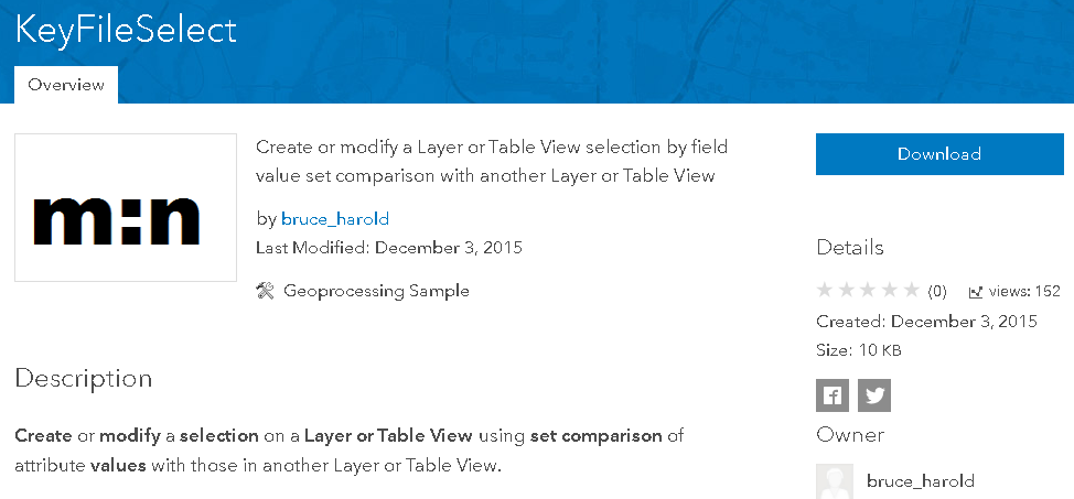

This tool will let you select values based on shared values in another table view:
http://pm.maps.arcgis.com/home/item.html?id=e638afe0695a4ad38388cb8d9b350446

Hi

It is accessible to:
Download contains toolbox and script:
Maybe try https? https://pm.maps.arcgis.com/home/item.html?id=e638afe0695a4ad38388cb8d9b350446

BruceHarold
Esri Frequent Contributor
I think this is the zip payload.
