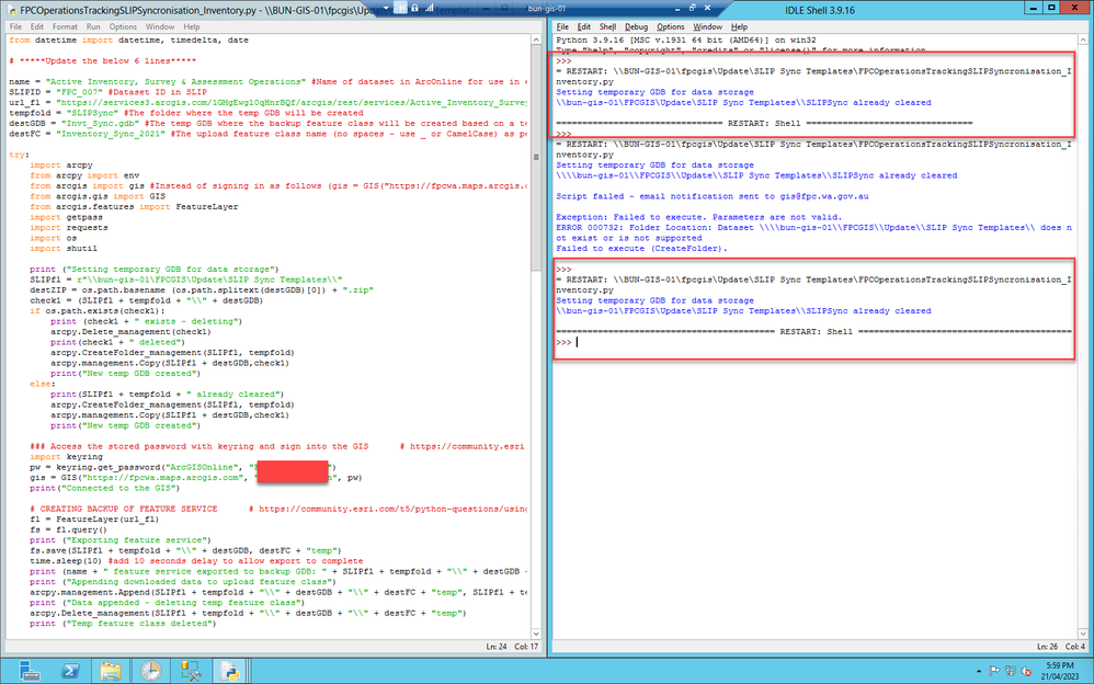

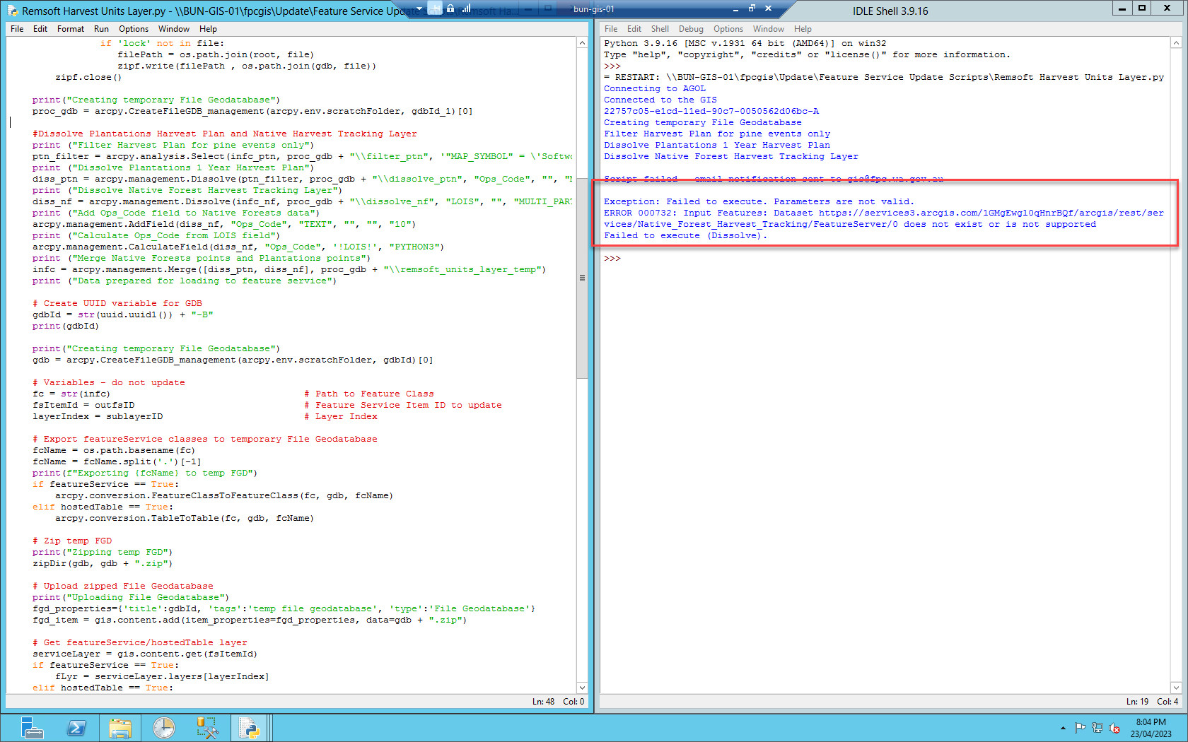

I have a python script that takes an ArcGIS Online feature service and uses it as an input in an arcpy Dissolve process. I built it (and ran it successfully) on my PC which was running ArcGIS Pro 3.1 but found it wouldn't work on our server which was still running 2.9.5. I put this down to advancements in the capabilities at the 3.0 upgrade and relevant python packages.
However, we recently upgraded our server to 3.1 as well and when I tried running this script on there, it fails complaining about the parameters (fails at the step where it tries to dissolve a feature service). Why would this be when all the software is supposedly the same?

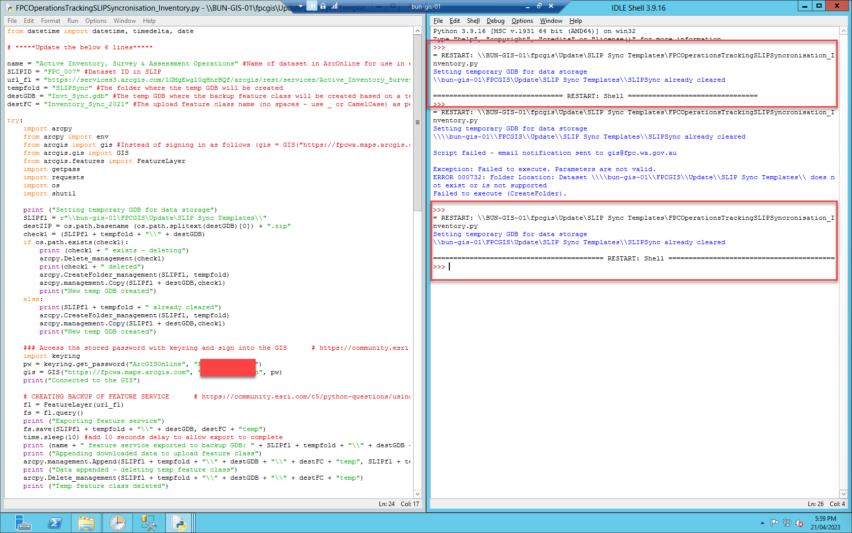

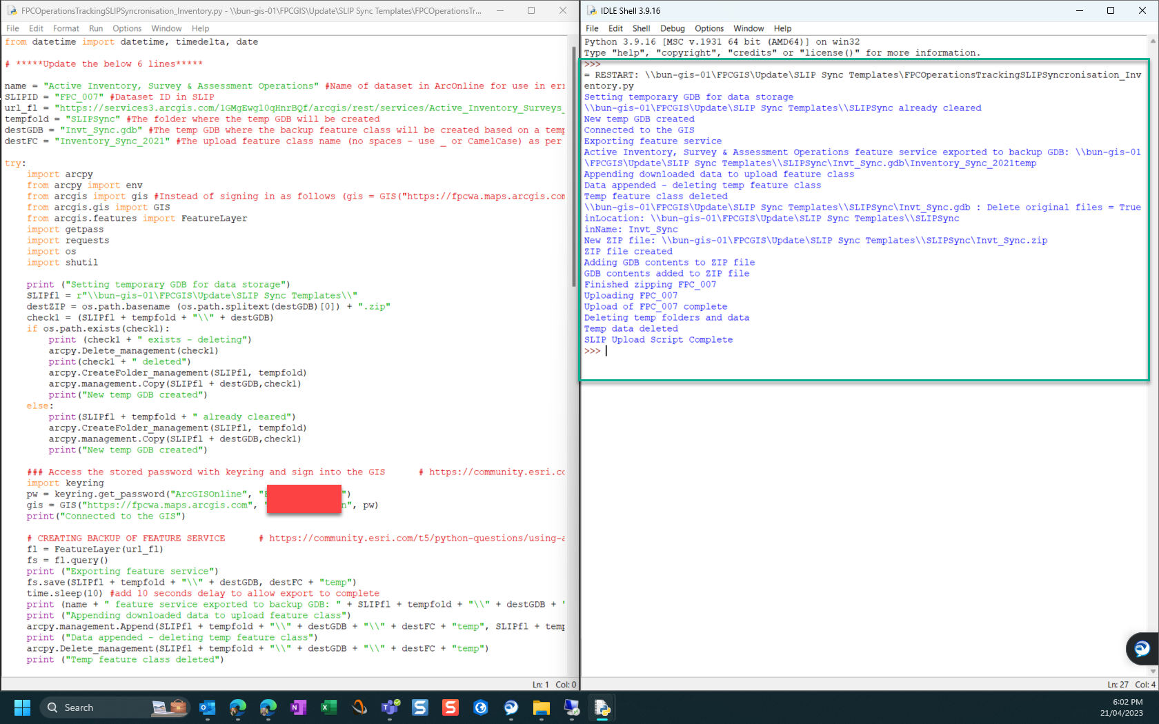

Also, other script that were running on the server have now inexplicably stopped working. No error codes, they just stop. Why?????

Is this a DMZ server? Maybe you need to open some firewall ports for the server to access that url. As for the other scripts just "stopping", do you have try/except blocks? What are you doing when you catch an Exception?

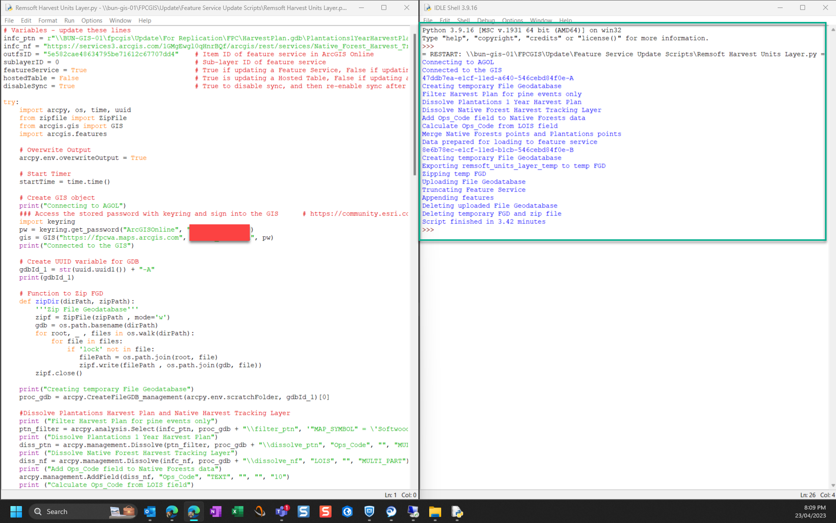

I'm not across the different server types. We ended up bringing forward the spin-up of a new server with clean installs and running a modern OS. The one used above was nearly a decade old and full of rubbish. The new server ran much cleaner, though the URL input parameter was still a problem.
I ended up finding a work around (or maybe "better") solution for the ArcGIS Online source data that did work without having to change anything else (which leads me to think the firewall wasn't an issue).
Instead of using the URL as the input parameter in the tool, I used it as the input parameter for the below code, then passed the local_fs parameter to the geoprocessing step.
print ("Export ArcGIS Online layer to feature class")
infc_nf = #"ArcGIS Online Feature Service URL here"
proc_gdb = #"path to GDB"
import arcgis.features
from arcgis.features import FeatureLayer
fl = FeatureLayer(infc_nf)
fs = fl.query()
local_fs = fs.save(proc_gdb, "local_fs")
print ("Dissolve layer")
diss_nf = arcpy.management.Dissolve(local_fs, proc_gdb + "\\dissolve_nf", "Field1", "", "MULTI_PART")
