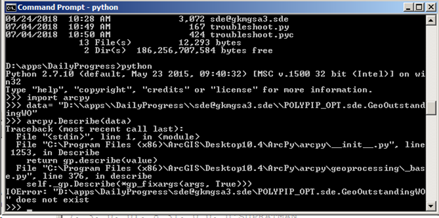

What is not working in the stand alone script

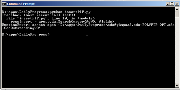

Accessing cursors return a RuntimeError.
arcpy.Describe raises an IOError

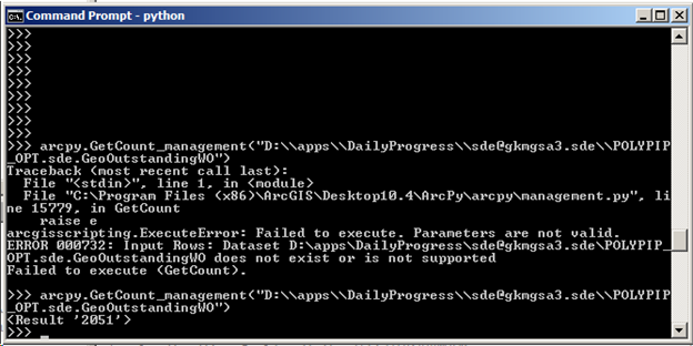

arcpy.GetCount_management and few others GP Tools raises an arcgisscripting.ExecuteError.

3. By chances, we found the solution is to run the arcpy.GetCount_management twice (after the first one raises an error).
4. We're doing step (3) as a work around and still trying to reproduce the error.

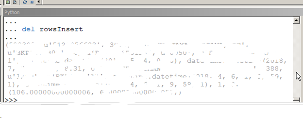

Figure 1 Displaying the first entry of the row in ArcMap’s Python window.
Figure 2 RuntimeError when executed as stand alone script via command prompt.
Figure 3 IOError when using arcpy.Describe()
Figure 4 Using arcpy.GetCount_management() raise an arcgisscripting.Exception, but works if repeated after the exception.
Figure 5 After exception was raised in figure 4, all of the subsequent code was working!
