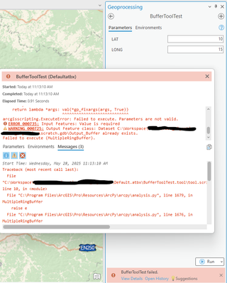

I'm trying to understand how to build a script tool that has multiple optional input parameters in conjunction with parameter validation.  Basically, I give the user two options to input a location that gets fed into a buffer tool. The first input option is to use an interactive map click using a feature set on the back end.  The second option is to allow the user to manually enter coordinates as the input location for the buffer tool.  When I set up parameter validation to disable the option not being used, the code behind still looks for the parameter/s even though the input has been disabled. I can't figure out how to get it to ignore the parameters that are not being entered by the disabled input options. Any advice would be much appreciated.
Here's the main script behind the tool:
import arcpy
arcpy.overwriteOutput = True
output_SR = arcpy.SpatialReference(4326)
output_gdb = "%scratchGDB%"
location_by_featureset = arcpy.GetParameter(0)
if location_by_featureset:
    Buffer = arcpy.analysis.MultipleRingBuffer(location_by_featureset, output_gdb+"\Output_Buffer", "20", "Miles")
else:
    Lat_Int = int(arcpy.GetParameterAsText(1))
    Long_Int = int(arcpy.GetParameterAsText(2))
    point_location = arcpy.management.CreateFeatureclass(output_gdb, "Point_Loc", "Point", "", "Enabled", "Enabled", output_SR)
    point_loc = arcpy.Point(Long_Int, Lat_Int)
    with arcpy.da.InsertCursor(point_location, ["SHAPE@XY"]) as cursor:
        cursor.insertRow([point_loc])
    del cursor
    Buffer = arcpy.analysis.MultipleRingBuffer(point_location, output_gdb+"\Output_Buffer", "20", "Miles")
arcpy.SetParameter(3, Buffer)
arcpy.AddMessage("Process Complete")

ewmahaffey
Thanks David.  I have all of the input parameters set as optional, but for whatever reason the tool still expects the the FeatureSet input param (0) to be populated if I choose to manually enter the coordinates. I think I need to use some more conditional statements, but I haven't figured that out yet.

OK, I think I've something working that uses a little of what each of you had recommended. I ended having to use a Try/Except statement in the main script to allow the tool to get past some of the parameters.  I'm not sure if it's correct, but it works. I plan to add some defaults for layer symbology, etc.  Thanks all!
Main Script:
import arcpy
#output_gdb = "%scratchGDB%"
arcpy.env.workspace = r"C:\Workspace\SMADS\Tool_Migration\Tool_Migration\Default.gdb"
output_gdb = arcpy.env.workspace
try:
except:
    del cursor
    arcpy.SetParameter(4, point_location)
