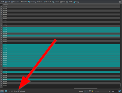

This is the result of my Script Tool right now. It has the records selected accurately based on my date range, but calculates the entire layer's Symbology field to "Beyond 90" when I need it to only calculate the selected records.
If I perform this process manually, the calculate field tool will use the 18 selected records and update those 18 selected records' fields only.

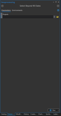

Sure thing. Here is the parameter in the properties pane and in the geoprocessing pane.
