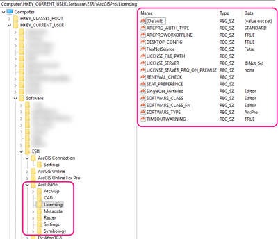

Background: I was gratefully advised by Pro-West Associates that they have seen this issue before, and it appears to be related to if the user account experiencing the RuntimeError has signed into ArcGIS Pro before. The issue is tied to the Windows Registry, and while I can confirm that's the case with our user experiencing issues, it's not always the case, only that the fix lies in the registry. I had two other User accounts on the same server that had also opened ArcGIS Pro, but import arcpy worked just fine for them when using the ArcGIS Server Python 3 environment. So, replicating the issue is difficult.
These are the steps taken to solve the RuntimeError for that one user we needed to be able to use arcpy in the ArcGIS Server Python 3 environment:

  4. Note the settings for [Computer\HKEY_CURRENT_USER\Software\ESRI\ArcGISPro] are:                      alex_friant_7-1746559767075.png

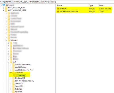

  5. Make those > ArcGISPro settings look like so:                                    alex_friant_5-1746559564192.png
  6. Close Registry Editor
  7. Sign out the user from Windows, Sign the user back in
  8. Test using Server’s Python 3 command prompt:                                                                       alex_friant_4-1746559529585.png
Reinstalling ArcGIS Pro after this point still results in a success as above. We will not have that user sign in to ArcGIS Pro out of concern that it might cause issues again (we've burned too much time on this issue at this point and must march forward.)

RuntimeError: The software is not authorized for use.
Work around was to rename the reg folder
Computer\HKEY_CURRENT_USER\Software\ESRI\ArcGISPro\Licensing to Computer\HKEY_CURRENT_USER\Software\ESRI\ArcGISPro\Licensing2
