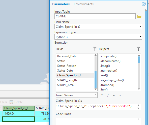

I can't find the answer anywhere, but how can I replace cells in a string field that have no data at all in them, with text? I'm not looking to replace spaces.
The second row here in Claim_Spend_in_£ (which is a text tield), has no data at all in it. It is not a blank space, or a NULL. I want all blank entries to be replaced with the text "Unrecorded". But the code I used above does nothing... I've tried using "", " ", None and neither of those work. I've also tried .strip to strip the field of any spaces first before running replace. No difference.
How can I acheive this?

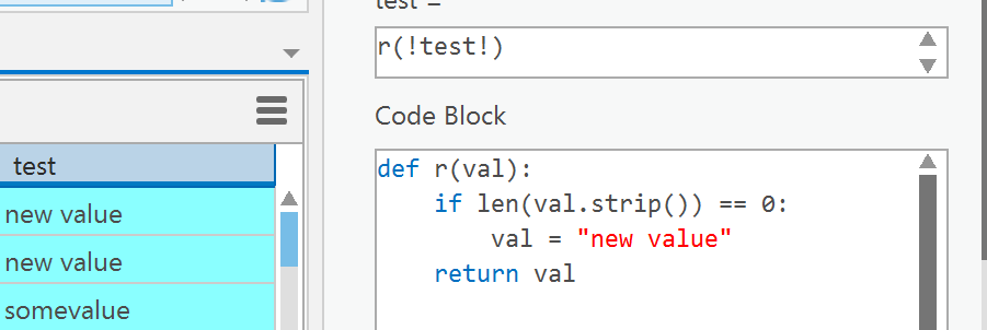

Try this... assuming it is some variant of a space or whitespace this field calculator expression should work
or it that fails you might try a variant

The first solution gave ERROR 999999:
and the second solution did the same:
Thanks for the help though! I'm going to try selecting all blank entries and then insert "Unrecorded" into those selected.

You indented the return line.
Don't
see my example

Ok interestingly my original code works with a few minor tweaks- swapping " " for ' '

'return' should use a single indent, you have double indented, hence it will fail
TheodoreF
Thanks Dan, both your solutions worked perfectly with the single indent. Interestingly when typing out your script it defautled to double indent when I hit Enter after the line ending "Unrecorded". I assumed Pro would handle indents for me.
