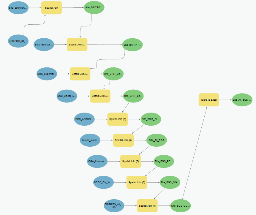

Hi I have a ArcGIS Pro model which takes a polygon shapefile (Site_boundary_master) and spatially joins various layers to it, finally exporting the final output to an Excel spreadsheet:
All the joining layers are kept in various File Geodatabases.
I saved the model as 'AutomationModel' (but in the properties dialogue for it, it's called 'Model222'... wtf?) in a toolbox called 'Automation.tbx'.
Running the model from Model Builder works fine.

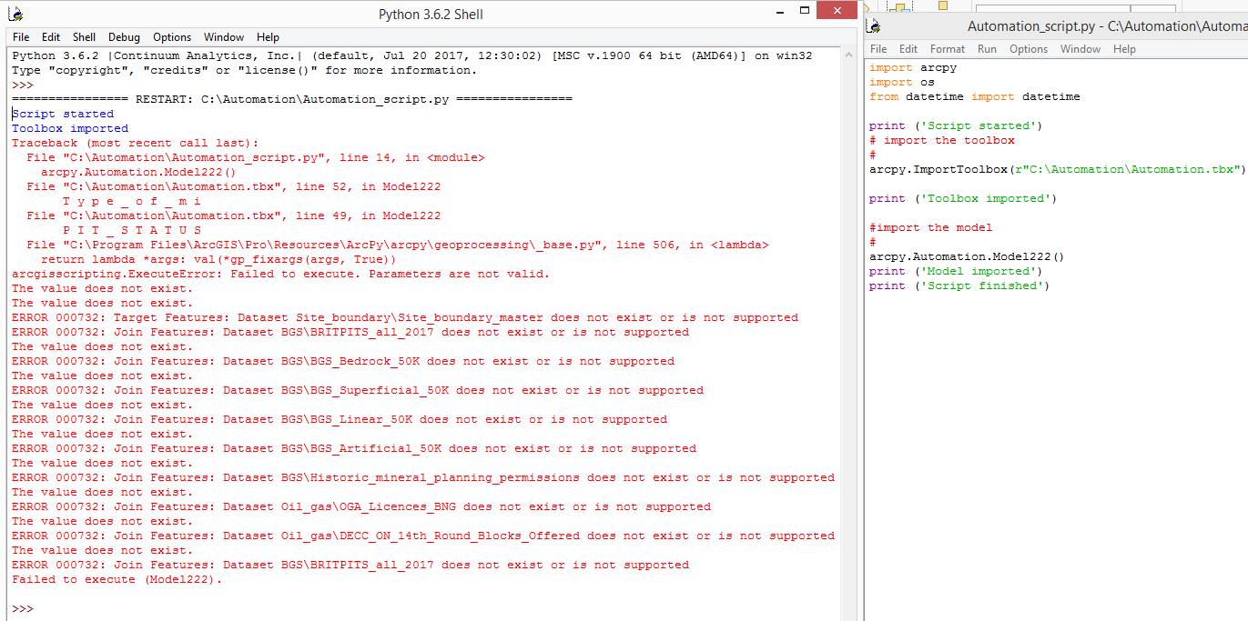

Pasting this code into the ArcGIS Pro python console, it work fine. Again.
However, when I edit the .py file in IDLE (ArcGIS Pro) and then run the script, it doesn't work at all:
Can someone help me fix this? Is it because I need to tell the script where all the input layers are stored? If so, how would I write this? I'm still a novice with python.

Yes.. the model and script run outside, have no clue where the data are.
arcpy.env.workspace = r"\C:\folder\containing\the_data"
if the data resides in one folder
Using a geodatabase would make things easier as well.

I would check the model to see if the full paths are set to the files, otherwise you may have to set the inputs as parameters to allow the user model to navigate to them.  If the model is converted to a script, you will probably find they are set that way.  If you intend to use the model with data in the exact same location you may not have issues.  However, if you create a model and intend to distribute it for others to use, then model components would have to use the same folder structure.  This is where models are good to get an idea of the workflow but really need to be used as a 'shell' to edit as a script tool so you can generalize the location of data inputs and outputs so that they can be found in locations 'relative to' the location of the script tool.

The paths are referring to the layers in the TOC. I should have set the model paths to look directly at the files/FCs when I created the Model.
The data should never move from it's current location, so that's not an issue.
The model will only run from my machine.
It's a shame I can't export an ArcGIS Pro model to python script like I could in ArcMap. It would make it quicker to re-source all my data sources.

So changing all the model's target and output to direct source locations (as opposed to TOC layers) has fixed this for me.
