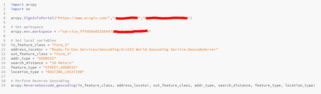

My script (standalone):

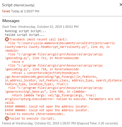

I added the script to Arcgis Pro toolbox, and tried to run it, and of course it failed with this error:
I know what's wrong here:

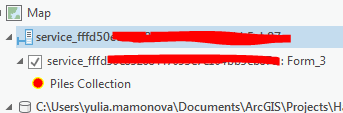

- arcpy.env.workspace -  As soon as my feature layer was created in Survey 123, it's not stored in geodatabase on my computer:
What should I do?
- input - output feature services - How should I modify the code to update the existing feature service, not to create one?
