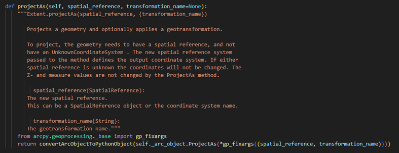

You might need to assign a transformation, according to the docstring for Extent.projectAs():
If your projection requires a transformation, you can use ListTransformations  to get a list of valid transformations and pass those to the call:
from arcpy import Extent, SpatialReference, ListTransformations
ext: Extent = parameters[0].value
srs = SpatialReference(4326)
transformation: str = ListTransformations(ext.spatialReference, srs, extent=ext)[0]
ext.projectAs(srs, transformation_name=transformation)
