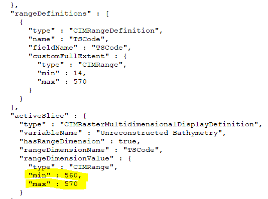

Hi, I'm trying to replace some characters within a lyrx file.
In this example I need to replace "570" with "560"
The problem I have is that two lines are identical but I only need to replace one (highlighted in yellow in the image below) and not the one a few lines above the highlighted one.
The code I'm using:
for i, line in enumerate(fileinput.input(OUT_workspace + "\\" + "AE000S560_005M5001P01M041.lyrx", inplace=1)):
    sys.stdout.write(line.replace('"max" : 570', '"max" : 560'))
I would really appreciate any help. I'm not sure how to target a specific line within the file. Many thanks.

Hi @anTonialcaraz,
I assume that you are using python. If that is the case, another option instead of using replace would be to create a dictionary so that the set values in the dictionary are overwritten to the value that you specify.
maxvalue = {"max": 560}
    #insert line exception below for specific line to update
    if i ==(line number to change):
        maxvalue["max"] = 570
        sys.stdout.write(maxvalue["max"])
Without knowing the code specifics, this is the only suggestion I can come up with at the moment.

You would need to access the activeSlice dictionary(wherever that is being stored), then access the rangeDimensionValue dictionary to set the max within that dictionary. To do that, you would simply need to find where the activeSlice is the key and then access the values within that key. Then access the rangeDimensionValue values to then set the max to the specified value.
You may be able to access that particular value as such:
"activeSlice"["rangeDimensionValue"]["max"]= maxvalue["max"]
I can't tell (based on the png) if those values are in both lists and dictionaries, or a combination of sorts. If you can find the activeSlice key, then you should be able to use the suggestion above to change the max value.

Please let me pass you the .lyrx file see if that makes things easier. I just need to replace the rangeDimensionValue of several files. For example, from 570 to 560. I was initially using line.replace but that would change the "customFullExtent" part as well and I need that to keep the same values.

Hi, why don’t you parse the lyrx and then you can address the “rangeDimensionValue” directly?

Couple things here- fileinput will basically create an list of lines from the text file so I don't think you can access the 'keys' as structured in the png or python dictionary. Enumerate creates an inplace tuple containing the index number and value (line).
Meaning line 706 will just look like '"max": 570' when you are iterating over it. To replace it, use '"max": 560'. Also, if you don't put anything back to the file if it doesn't match in the if, fileinput erases it which is probably why you only ended up with 560.
    if i == 760:
        sys.stdout.write("max": 560) # or '"max": 560', im not sure which would work
    else:
        sys.stdout.write(line)

Treat the entire file as one string with newlines embedded in it, then use "replace".
lyrx is the string containing the entire file
Line 3 looks for the pattern of 560 on a line and "max" on the next line then replaces that with the new value
with open("file.lyrx") as fp:
  lyrx = fp.read()
lyrx.replace('560,\n"max"', '570,\n"max"'))
If you want a more general approach that deals with random whitespace you could use the re.sub instead, you can go down a real rabbit hole with regex though so use plain old replace unless you are getting fancy.
import re
fixed = re.sub('560,\s*"max"','570,\n"max"',lyrx)
