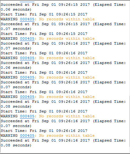

This doesn't quite work as intended, though.  The script iterates through each feature and enters the appropriate amount of entries, but it does not populate the Circuit ID field.  Each time it tries to do so, I get an error:
Here is the error documentation for reference:  000405: No records within table.—Help | ArcGIS Desktop
JoshuaBixby
MVP Esteemed Contributor
The code I provided should populate the CircuitID when the records are inserted/copied into the new table, so that warning and your statement that the records get inserted confuses me.  You should no longer be using Calculate Field.  Can you post your code?

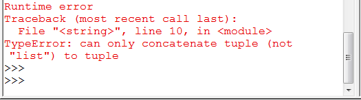

I actually just ran my code in the Python window within ArcMap, right up to the point where I call out the local variables for the loop.  Then I copy/pasted your code from above to finish out the loop.  Strangely, though, after reopening the map that I was using and attempting it once again, I now get the following error:
And no records got inserted.

DanPatterson_Retired
MVP Emeritus
just convert the list to a tuple or the tuple to a list
a = (1, 2, 3)
b = (4, 5, 6)
c = [7, 8, 9]
a + b
Out[8]: (1, 2, 3, 4, 5, 6)
a + c
  File "<ipython-input-9-ca57d551b7f3>", line 1, in <module>
    a + c
TypeError: can only concatenate tuple (not "list") to tuple
a + tuple(c)
Out[10]: (1, 2, 3, 7, 8, 9)

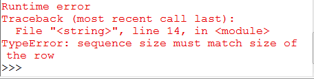

I added the tuple() in the call to circuitID, admittedly via guessing, but now I get a new error:
Was I correct in where I placed tuple()?
In reference to the new error, I looked up Error: TypeError: sequence size must match size of the row, but I can't quite figure out what needs fixed in my code to adhere to this rule.

Unfortunately, line 10 from the error code doesn't correspond to the line 10 in the code snippet you posted back because there is no way that Termination = row[4]would generate that error.  Without seeing the entire code block, I can't suggest how to change your code to remove the type error.
