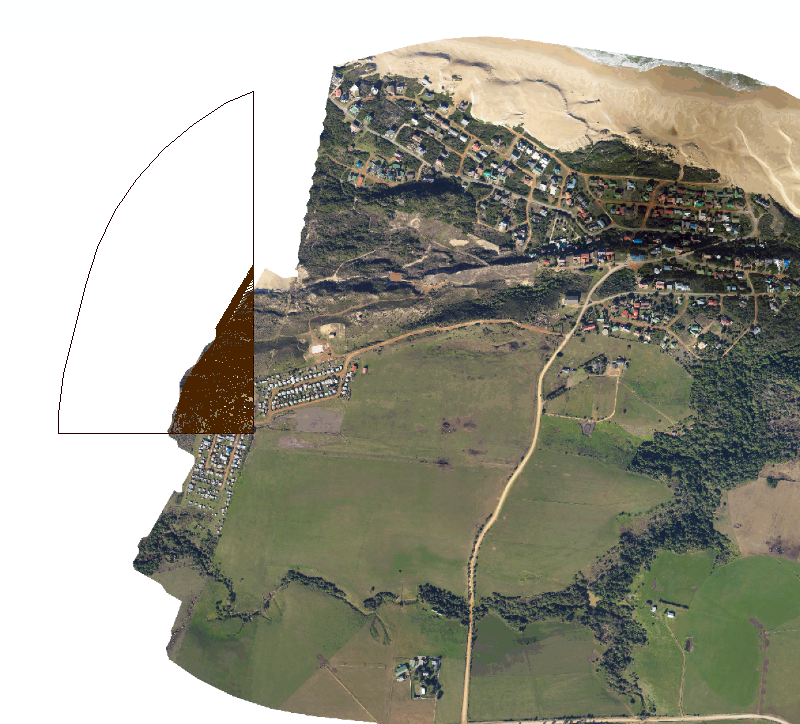

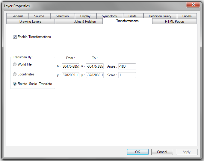

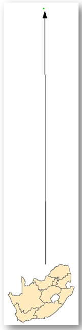

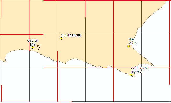

I have received imagery from a surveyor that is currently falling within the Northern Hemisphere and upside down. The following is easy to resolve if its a CAD drawing using the "Transformations" tab under the properties window of the CAD layer within ArcMap. Is there a way to apply the same transformation using Python for each image tile?
CAD: Transformation
Original Position: Northern Hemisphere and rotated.

CAD: Transformed (correct location)
Imagery: Current Imagery (Northern hemisphere and rotated)
Any assistance to achieve the following will be appreciated.

Have you tried Flip—Help | ArcGIS Desktop ?

I bet you don't have world files for the images... Sounds like a missing negative sign and a flop of the X and Y coordinates...  World files would be a lot faster to fix
