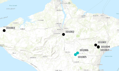

Here is some sample data, note 2 points are selected:

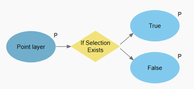

Here is the sub-model (This I called Select Model), with a single selection exist tool:
Here is the master model:
If a selection exists as determined by the sub-model (Select Model) then buffer the selection, else do a selection based upon ID. All logic ran as expected, may be you were not exposing the parameters of the sub-model as Parameters (those P's)?
