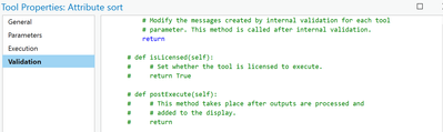

Catalog, Project tab, Toolboxes with my toolbox which has a tool with a toolset and a tool shown
which you can launch and run to test whether it works or check its properties
for tool validation... (postExecute is commented out here since none is needed)
