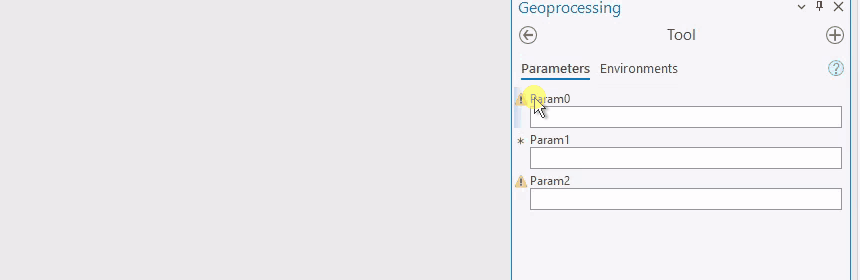

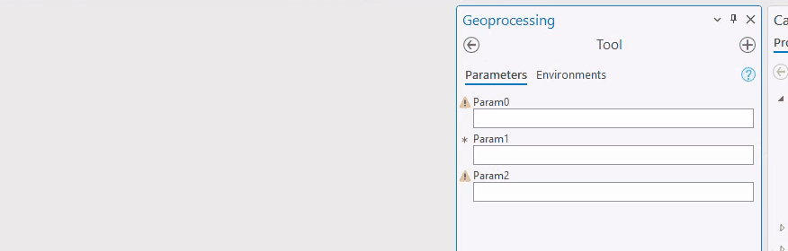

What I've found by experimenting this morning is that I could only really get something useable for altered and hasBeenValidated in updateMessages(), so that's what this example is going to use.
I'm not sure if that's always true, but it does stand to reason that hasBeenValidated is only helpful after updateParameters(), since that's when validation happens.
It goes: getParameterInfo()-->updateParameters()-->updateMessages(), in that order. updateParameters() gets called when you make any chance, and updateMessages() is called immediately after.
In any case, here's what I think the difference is.
altered: Is the parameter's current value different from None? This includes setting the default value, which is kind of dumb but whatever.

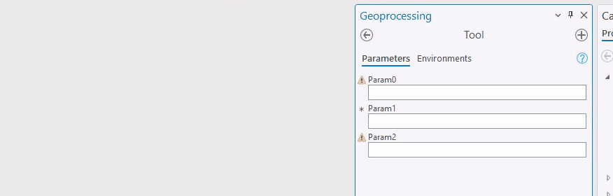

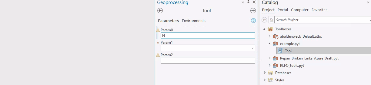

If I've set the default:
hasBeenValidated: Is there are error on the parameter?
    def updateParameters(self, parameters):
        param0 = parameters[0]
        if param0.value == "Y":
            param1.filter.list = ["apple", "pear"]
        elif param0.value == "N":
            param1.filter.list = ["strawberry", "pineapple"]
        return
    def updateMessages(self, parameters):
        param1 = parameters[1]
        param2 = parameters[2]
        if param1.hasBeenValidated:
            param2.setWarningMessage("param1 is validated, yeah")
        else:
            param2.setWarningMessage("param1 is not validated yet")
