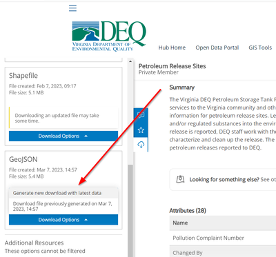

kapalczynski
I can manually do it here but I want to do this programmatically
