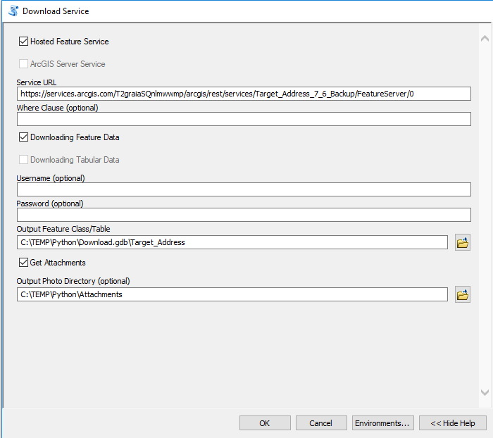

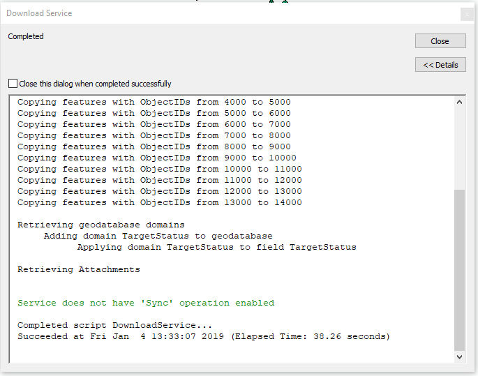

I ran the following tool:
And this worked successfully, except for the attachments.  Sync will need to be enabled for attachments to be download with the referenced tool:
