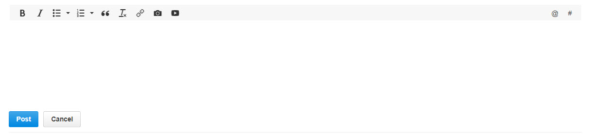

Unfortunately I don't have the "..." option. See my comment screen below.
JakeSkinner
Esri Esteemed Contributor
Click on the question, and then reply.  If you reply in your Inbox, you won't have that option.
