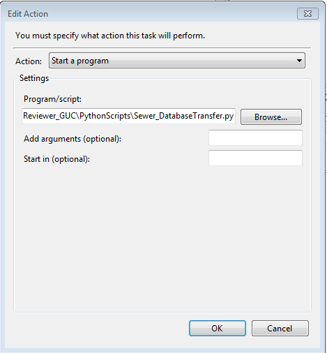

And what are you including in the "Program/script" field in the "Edit/Action" text box? I don't remember if models are exposed itself as any kind of executable file or only tbx files are....
Jesús de Diego
JonahWaterman
1.pngC:\DataReviewer_GUC\PythonScripts\Sewer_DatabaseTransfer.py
This is what is under the Progra/Script
