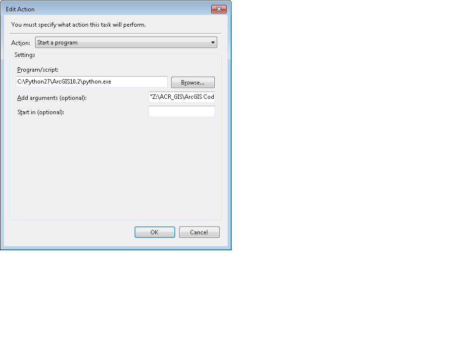

I have created a model to delete a database and then copy the sde feature classes to a file geodatabse and it works sucessfully in modelbuilder when I try and schedule it as a task in Windows scheduler its running but not giving me my results, I keep getting a (0X1) expression under theLastsuccessfully tab. THX FOR YOUR HELP1.png2.png3.png4.png

First of all, have you tried cheking  the.. "...highest privileges" check box?
As you are running a Python script I think you should introduce in this text box ("Program/script") the Python.exe executable (if you're using ArcGIS 10.1, per example, C:\Python27\ArcGIS10.1\python.exe ). In the "Add argument" I should include the complete location of the Python script and its parameters (it the script has parameters).

To follow up with what Jesus is saying, at the next release of Desktop you will have python 2.7 and python 3.4 installed, so you will need to point some scripts to 2.7 and some to 3.4 especially as some are ready to move forward and some are not, so with that said, you will reference the executable directly in the Program, and the actual path to the script in the Add Argument.  So for instance if you want to do an analysis script you could reference the python 3.4 exe, with a Argument of "the path to script", while some scripts may need to do topology checks, and those will need to still be able to just run under python 2.7, with the argument of "path to script".  Its probably best to practice now, since this is the way it will become in the future with the release of Pro.

You have that radio button for "Run only when user is logged on" clicked.  Is your account still logged on when the script is scheduled?
