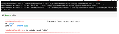

Hi Dan,
Thanks for writing back. I have already pip installed in the arcgis clone environment, but when I try to subsequently import the library into arcgis for use, I get a ModuleNotFound error message.

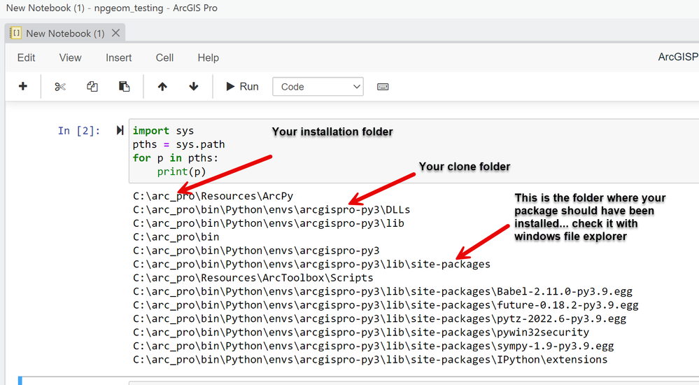

If that is the environment that it is installed in, and the jupyter notebook uses the same environment
From a Notebook inside of Pro with your clone activated, do the following.
You will have to substitute your install folder, your clone name to check.  Then fire up windows file explorer and see if the package is installed there.

GraceHegland
Hi Dan,
I checked the folder where you said the package should be installing, and it was not listed there. I looked back at my pip install command and can see that it is installing to a different file pathway. How can I adjust the pip install command so that it is installing in the correct place?
