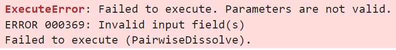

and get the following error.
I narrowed the issue down to two field names, FolderPath, PopupInfo.  Renaming the fields to folderpath, and popupinfo fixed the problem.  Any ideas why this error occurred and why the fix worked?  Thx.

searchable error:
ExecuteError: Failed to execute. Parameters are not valid.
ERROR 000369: Invalid input field(s)
Failed to execute (PairwiseDissolve).

They look like reserved words in the dropdown data types for parameters to me. Maybe escape them somehow if you have to use them. If you run arcpy.ValidateFieldName() it might prepend underscores if the test finds unacceptable field names. Its a fairly bad bug that these keywords have overflowed into the parameter space.
