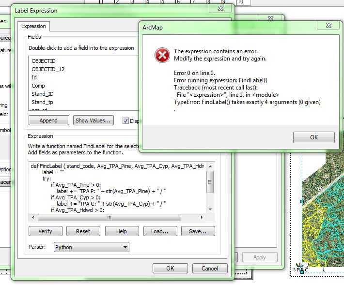

Maybe the attached table will help.
And of course the error message in ArcGIS isn't selectable to copy and paste ...
DarrenWiens2
MVP Alum
You must (?) enclose your field names in brackets (as you did long before) in the label expression FindLabel function :
def FindLabel ( [stand_code], [Avg_TPA_Pine], [Avg_TPA_Cyp], [Avg_TPA_Hdwd] ):
JoshuaBixby
MVP Esteemed Contributor
I will save any explanations until after I see whether this works for you:
def FindLabel ( [stand_code], [Avg_TPA_Pi], [Avg_TPA_Cy], [Avg_TPA_Hd] ):
    stand_code = [stand_code]
    Avg_TPA_Pine = [Avg_TPA_Pi]
    Avg_TPA_Cyp = [Avg_TPA_Cy]
    Avg_TPA_Hdwd = [Avg_TPA_Hd]
    label = ""
    try:
          if int(Avg_TPA_Pine) > 0:
              label += "TPA P: " + Avg_TPA_Pine + " / "
          if int(Avg_TPA_Cyp) > 0:
              label += "TPA C: " + Avg_TPA_Cyp + " / "
          if int(Avg_TPA_Hdwd) > 0:
              label += "TPA H: " + Avg_TPA_Hdwd
          return stand_code + '\n'+ label
    except:
          return  stand_code
