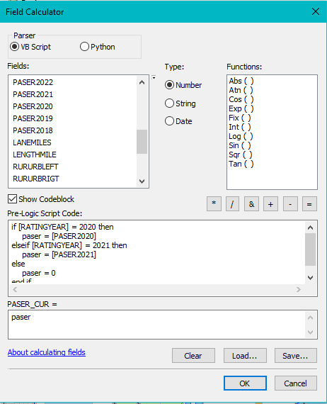

I am trying to do a simple if statement in ArcMap to calculate a new field. It takes the year that an attribute was rated from the "[RatingYear]" field and depending on that value, chooses the corresponding "[PASER<year>]" field value.
I want to learn more about Python coding, but can't get this to translate to Python. Is it possible to set a variable to a field value in Python?

Brian_Wilson
Honored Contributor
The syntax for fields is different, it uses ! instead of []. I find that it's better to call a function and pass the values into it so that I don't have to deal with the weird syntax in my own code, here is a snapshot for an example.
I called the variables var1 and var2 in the function and call the function in the expression below.
Translating your code would look something like this
def f(y, p2020, p2021):
  if y == 2020:
    return p2020
  elif y == 2021:
    return p2021
  return 0
PASER_CLR =
f(!RATINGYEAR!, !PASER2020!, !PASER2021!)
It keeps what I am doing separate from the dataset then too in my mind it's less confusing.
