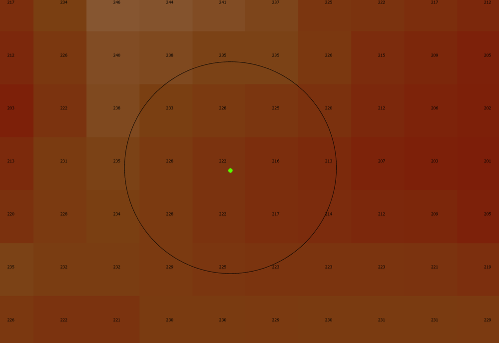

So here is some sample data, a green sample point and the background raster labelled with its cell values. The circle is showing a radius, in this case 100m to depict the neighbourhood.

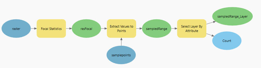

 The three step model is this:
The focal statistics tool is set to create a circular neighbourhood and extract the RANGE within that neighbourhood. This range value is passed through to the points and then I simply select all points with a range > 1.

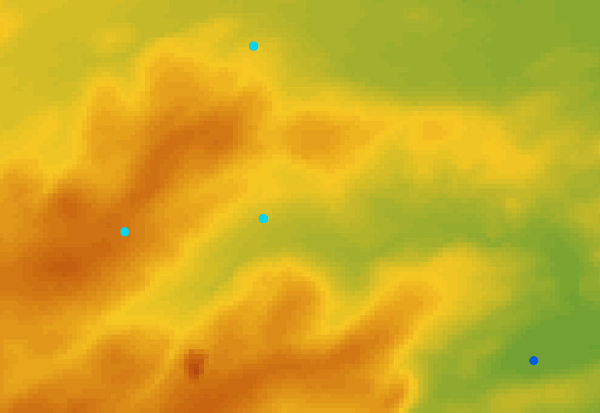

Here is a screenshot showing 3 points selected whilst 1 remains unselected (dark blue) to prove that the logic works.
